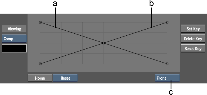

    The Luminance curve appears.
    (a) Front matte curve  (b) Back matte curve  (c) Front/Back box    

  3. To adjust the luminance curve for the front matte, select Front from the Front/Back box. To adjust the back matte curve, select Back. Alternatively, click a curve to select it.
    The selected curve changes to white.

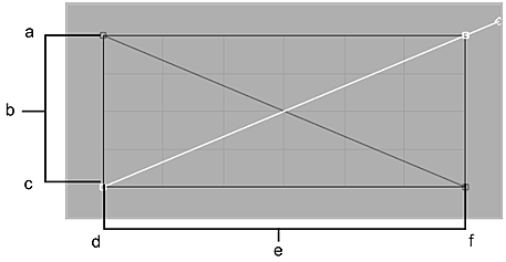

    (a) 255 (White)  (b) Output (remapping of luminance values)  (c) 0 (Black)  (d) 0 (Black)  (e) Input (current luminance values)  (f) 255 (White)  
  4. Click a point to display its tangent handle and drag the handle to adjust the curve. Use other modes in the Tools box to further adjust the curve, adding or deleting points or breaking tangent handles, as needed.
