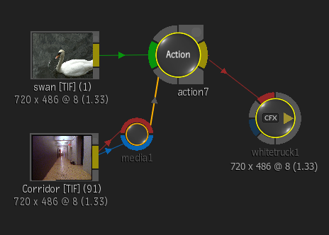

The following example displays indirect media in Action. The swan clip is attached to the Action node as the back clip, whereas the Corridor clip is attached to an Action media node as the front and matte media.
