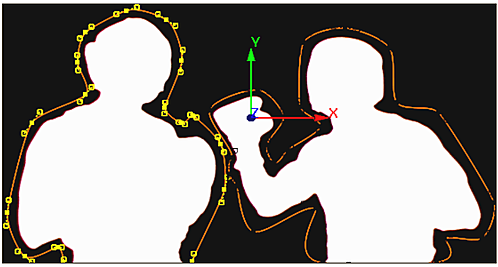

In the GMask node in ConnectFX and the Modular Keyer,you also have the option of using the Tracer with an advanced gradient. The Tracer is an additional softness tool you can use to pull a key from scratch. This allows you to key images with a lot of detail at the edges. It uses a system of localized keys, called pickers, which analyse the colour information both inside and outside the mask to derive a key for the mask edge. You can use both the Tracer and the advanced gradient within the same garbage mask.

![]() Garbage mask with pickers sampling image for more advanced softness .Image courtesy of Behavior Communications Inc. |
![]() Garbage mask with pickers applied to only select vertices, the remainder using an advanced gradient .Image courtesy of Behavior Communications Inc. |
