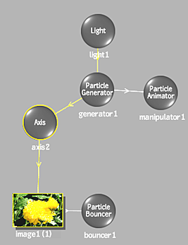

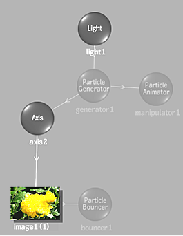

When importing a setup that contains non-supported objects (such as particles and deformations in Smoke), these objects are displayed as greyed out nodes in the schematic, and greyed out menus in the Object menu. These greyed out objects are read-only objects that can be viewed (in the image window and the Object menu), but not modified or linked to or from. In Channels view, you can view the parent channel for the non-supported object, and in Tracks view, you can slide or stretch the parent channel. If you modify the setup and re-save it, you can then open it in the application that supports the objects, and modify all objects.
![]() Schematic of Flame setup |
![]() Schematic of same setup opened in Smoke |
