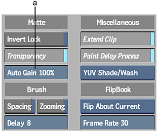

Unwanted grey areas can be removed from the matte by increasing the percentage in the Auto Gain field in the Setup menu.
(a) Auto Gain field  
Pixel values between the minimum and maximum values are multiplied by the Gain value. The resulting values are clipped at the specified maximum luminance value. The Gain is expressed as a percentage value. The default value of 100% has no effect on the image since the luminance values are multiplied by 1.

  4. Set the Auto Gain for the matte. The Auto Gain field is in the Setup menu.
