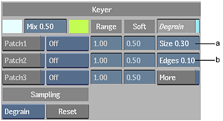

  1. In the Master Keyer menu, select Degrain from the Sampling box.

  4. Drag in the Degrain fields to modify the grain size and restore edge sharpness.
    (a) Size field  (b) Edges field  
    Drag: To:
    Size Estimate the size of the grain in the image.
    Edges De-sharpen the edge of the image. By default, Degrain sharpens the edges. Use the Edges field to restore the natural look of the edges in the image.
