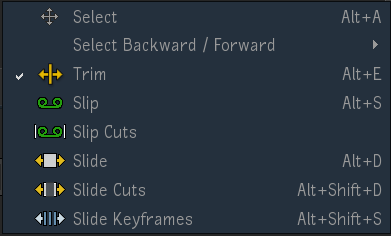

You can determine the keyboard shortcut assigned to a button from anywhere within Smoke.
To determine the keyboard shortcut for a button:
  1. If auto display of tooltips is enabled in the Preferences, hover over the button for which you want to determine the assigned keyboard shortcut. If you have disabled the auto display of tooltips, press and hold Ctrl+Alt+W and hover over the button.
    If a keyboard shortcut exists for the button, it is displayed in the tooltip.
  2. In some cases where dropdown list items have separate keyboard shortcuts, the list items display the various shortcuts.
