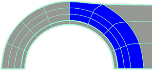

Creates a T-Spline body for a front and rear wheel base, and optionally, a connecting side panel.
Sculpt
Primitives
Wheel Arch
No Panel, 3 Across Faces, 8 Around Faces, 180 degree Rotation
Panel, 3 Across Faces, 8 Around Faces, 4 Width Faces, 180 degree Rotation
Wheel Arch
Front Wheel Arch
- Center Point X, Y
- Specifies the center point of the front wheel arch.
- Inner Radius
- Specifies the radius of the inner edge of the front wheel arch.
- Face Inner Width
- Specifies the width of the inner row of faces of the front wheel arch.
- Face Outer Width
- Specifies the width of the outer rows of faces of the front wheel arch. Use
Across Faces to specify the number of faces across this outer width.
When
Side Panel is selected, the width of the last row of faces increases automatically to blend with the panel.
- Rotation
- Specifies the angle that the front wheel arch sweeps across.
Rear Wheel Arch
- Center Point X, Y
- Specifies the center point of the rear wheel arch.
- Inner Radius
- Specifies the radius of the inner edge of the rear wheel arch.
- Face Inner Width
- Specifies the width of the inner row of faces of the rear wheel arch.
- Face Outer Width
- Specifies the width of the outer rows of faces of the rear wheel arch. Use
- Rotation
- Specifies the angle that the rear wheel arch sweeps across.
- Across Faces
- Specifies the number of faces across the outer width of the wheel arches.
- Around Faces
- Specifies the number of face around the wheel arch.
- Side Panel
- Creates a side panel between the front and rear wheel arch.
- Width Faces
- Specifies the number of faces across the width of the side panel.
