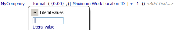

For example, you might add a prefix and/or suffix to the default name. Enter the prefix or suffix as a Literal Value. You can use the Function
Format to create a default work location name such as MyCompany01, MyCompany02. The rule would be:
MyCompany format ({0:00}, ([Maxiumum Work Location ID] + 1))
