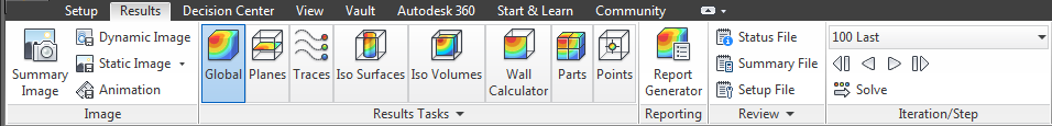

The Results tab is divided into several primary functions:
To access the Results tasks while in the Setup tasks, click the Results tab.

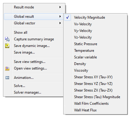

To specify the result quantity displayed on model surfaces, right click, and select Global result:

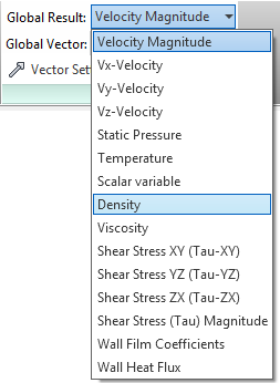

Alternatively, select from the Global Result menu on the Global context panel:
The global result is reflected in the Legend in the graphics window. Changing the units of the Legend changes the output units when probing.
This also sets the result quantity displayed in the Status Bar when probing with the mouse. (To probe, hover the mouse over the location of interest.)

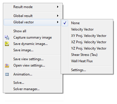

To display vectors on all fluid surfaces (inlets, outlets, and internal surfaces between fluid regions), right click and select Global vector. Select the desired quantity from the expanding menu list.
Use the Settings… dialog to control vector attributes such as length and arrowhead size.
Alternatively, select from the Global Vector menu on the Global context panel.

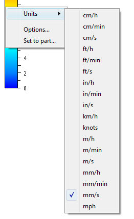

To change displayed units
Right-click on the legend, and select Units.

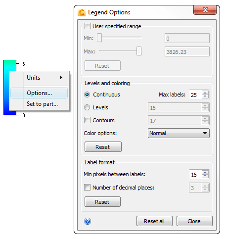

To modify legend appearance
Right click on the legend, and click Options.
To change the range
Levels and Coloring
Label spacing and format
Legend vertical spacing

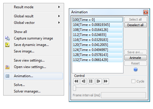

A very effective way to visualize results from transient analyses is to save results at specific time steps, and animate them to see how they change with time.
Alternatively, click Results (tab) > Image (panel) > Animation to open the Animation dialog.
Use the Animation dialog to animate saved iterations or time-steps.
To open the Animation dialog
To animate results sets
To save an animation
