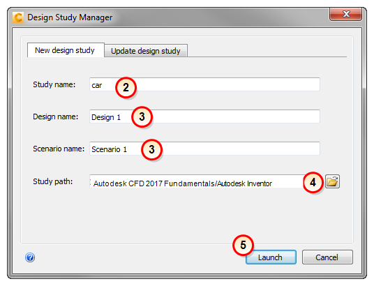

The Design Study Manager is an interactive tool for coordinating your CAD models and Design Studies in real-time.
It is a powerful way to manage Design Studies, Designs, and Scenarios. It allows you to easily update them from your CAD tool without having to exit Autodesk® CFD.
The Design Study Manager opens automatically when you launch Autodesk® CFD from CAD. It is highly versatile, and contains several functions:
Additionally, use the Design Study Manager for the following:
We will explore these later in the Fundamentals Training.
Optionally, click here to see an example of creating a new design study...
Optionally, click here to learn more about the Design Study Manager...

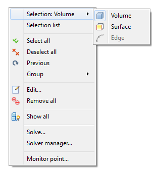

There are several ways to set the selection mode to volume, surface, or edge:
