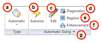

Automatic Sizing
There are several ways to apply Automatic Sizing:

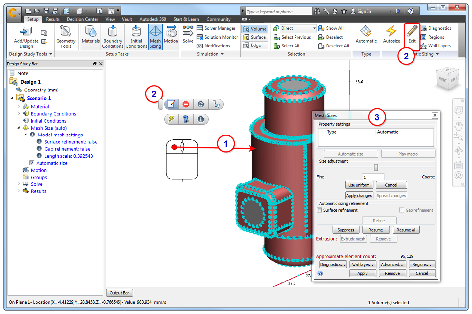

Mesh Tools
Use the Mesh Tools to customize the mesh distribution. All tools are accessible from the Mesh Sizes quick edit dialog. To simplify the workflow, many are also available on the context tool bar and on the context panel.
Context tool bar
Left click on or near the model:
Context panel in the Ribbon
On-model mesh modification
