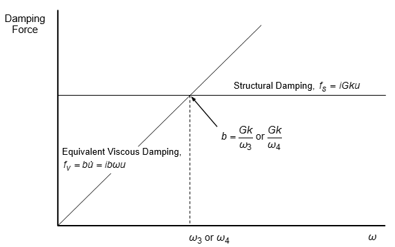

Assuming constant amplitude oscillatory response for a single degree of freedom system, the two damping forces are identical if:
or
Therefore, if structural damping
is to be modeled using equivalent viscous damping b, then the equality holds at only one frequency (see image below).
Two parameters are used to convert structural damping to equivalent viscous damping. An overall structural damping coefficient can be applied to the entire system stiffness matrix using PARAM, W3, r where r is the circular frequency at which damping is made equivalent. This parameter is used along with PARAM, G. The default for W3 is zero, which results in damping from this source to be ignored in transient analysis.
PARAM, W4 is an alternate parameter used to convert element structural damping to equivalent viscous damping. PARAM, W4, r is used, where r is the circular frequency at which damping is to be made equivalent. PARAM, W4 is used along with the GE field on the MATi entry. The default for W4 is zero, which results in damping from this source to be ignored in transient analysis.
Units for PARAM, W3 and PARAM, W4 are in radians per unit time. The choice of W3 or W4 is typically the dominant frequency at which damping is active. Often, the first natural frequency is selected, but isolated individual element damping can occur at different frequencies and can be handled by the appropriate data entries.
