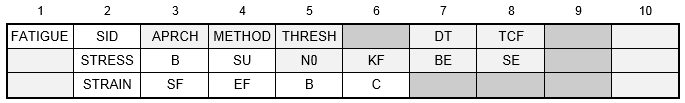

FATIGUE
Multiaxial Fatigue Data
Description: Defines data needed for multiaxial fatigue analysis.
Format:
Example:
Field Definition Type Default
SID Set identification number. Integer > 0 Required
APRCH Fatigue life approach, one of the following character variables: STRESS, STRAIN, or blank. Character See Remark 2
METHOD Life calculation method, selected by one of the following values
1 = von Mises stress/strain
2 = Maximum principal stress/strain
3 = Maximum shear stress/strain
Integer 2
THRESH Percentage of amplitude threshold. See Remark 5. Real ≥ 0.0 0.0
DT Event duration used to determine life. See Remark 6. Real > 0.0 See Remark 6
TCF Factor to convert DT and life output to units other than seconds. See Remark 6. Real > 0.0 1.0
B S-N curve slope. See Remark 3. Real > 0.0 See Remark 2
SU Intercept stress level. Typically taken as the material ultimate stress. See Remark 3. Real > 0.0 See Remark 2
N0 Intercept cycles. See Remark 3. Integer > 0 1000
KF Factor applied to compensate for life reduction effects such as finish, corrosion, and notch effects. See Remark 3. Real > 0.0 1.0
BE Slope after endurance limit. See Remark 3. Real > 0.0 0.1*B
SE Endurance limit. See Remark 3. Real ≥ 0.0 0.2*SU
SF Coefficient of fatigue strength. See Remark 4. Real > 0.0 See Remark 2
EF Coefficient of fatigue ductility. See Remark 4. Real > 0.0 See Remark 2
B Exponent of fatigue strength. See Remark 4. Real > 0.0 See Remark 2
C Exponent of fatigue ductility. See Remark 4. Real > 0.0 See Remark 2
