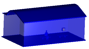

Transparent
Display the transparent view of the model. Use this style to view internal features in addition to model surfaces.
Material Based
Display all fluid material parts as transparent and all solid material parts as solids.
Note: In the image on the right, the surrounding wall, which is a solid material, was hidden to show the fluid material and the immersed solid parts.

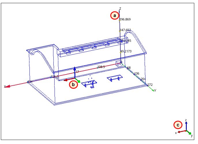

Axes
Expand the Axes menu to toggle the display of the three coordinate axes:
a. Bounding Coordinate Axis
b. Local Coordinate Axis
c. Global Axis
The value in the adjacent field is the number of axis increments. Change this number with the arrows to the right of the field.

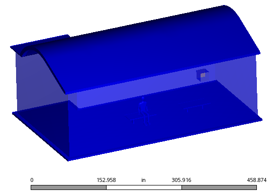

Scale
Toggle the display of the model scale. This is useful for understanding the physical length of the model.
