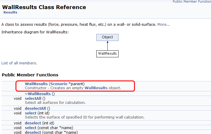

wr = Results.WallResults(scenario)
>>> Initialize the parameters needed for the wall results. Click Results on the Module page to access the WallResults class. The WallResults command is on the WallResults Class page:

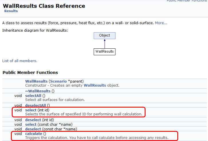

wr.select(15)
wr.select(9)
wr.calculate()
>>> Use the Select function to select specific surfaces with the ID numbers (in this case surfaces 15 and 9). Use the Calculate function to trigger the calculation.

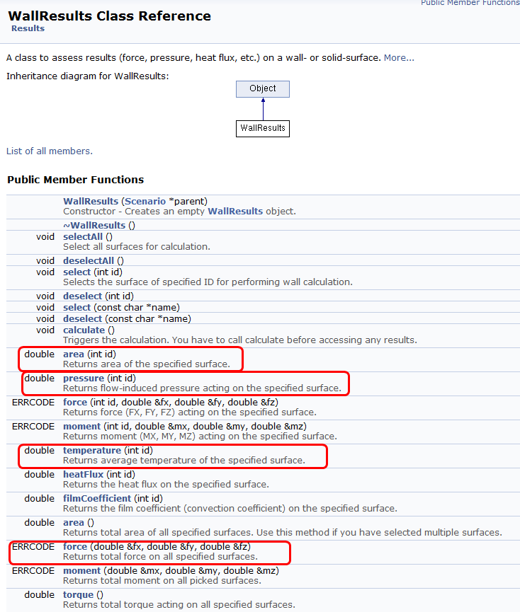

area = wr.area(15)
pressure = wr.pressure(15)
temp = wr.temperature(15)
fx, fy, fz = 0.0, 0.0, 0.0 # force is a little complicated because it is 3 values
err, fx, fy, fz = wr.force(fx, fy, fz)
>>> Compute the area, pressure, and temperature on the surface. Use the force function to compute the three force components:

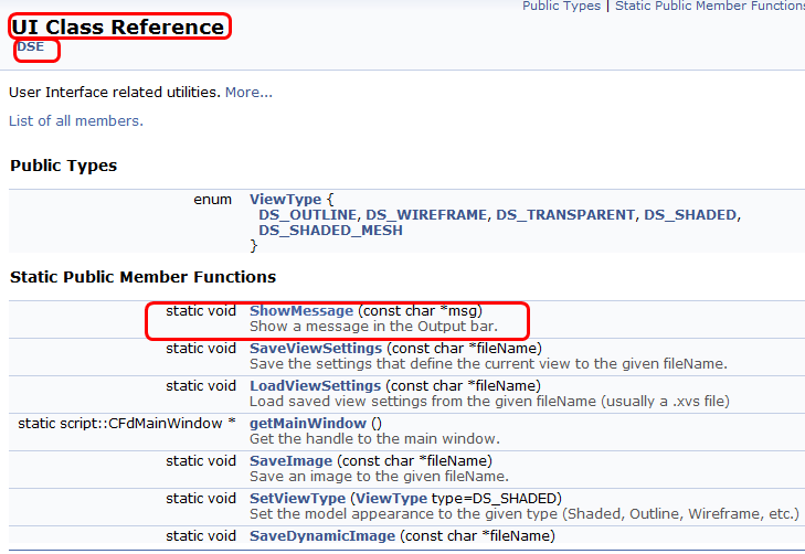

DSE.UI.ShowMessage( "Area = " + str(area) )
DSE.UI.ShowMessage( "Press = " + str(pressure) )
DSE.UI.ShowMessage( "Temp = " + str(temp) )
DSE.UI.ShowMessage( "FX = " + str(fx) )
DSE.UI.ShowMessage( "FY = " + str(fy) )
DSE.UI.ShowMessage( "FZ = " + str(fz) )
>>> Display the strings in the Output bar. These commands use the ShowMessage function of the UI class of the DSE module:
