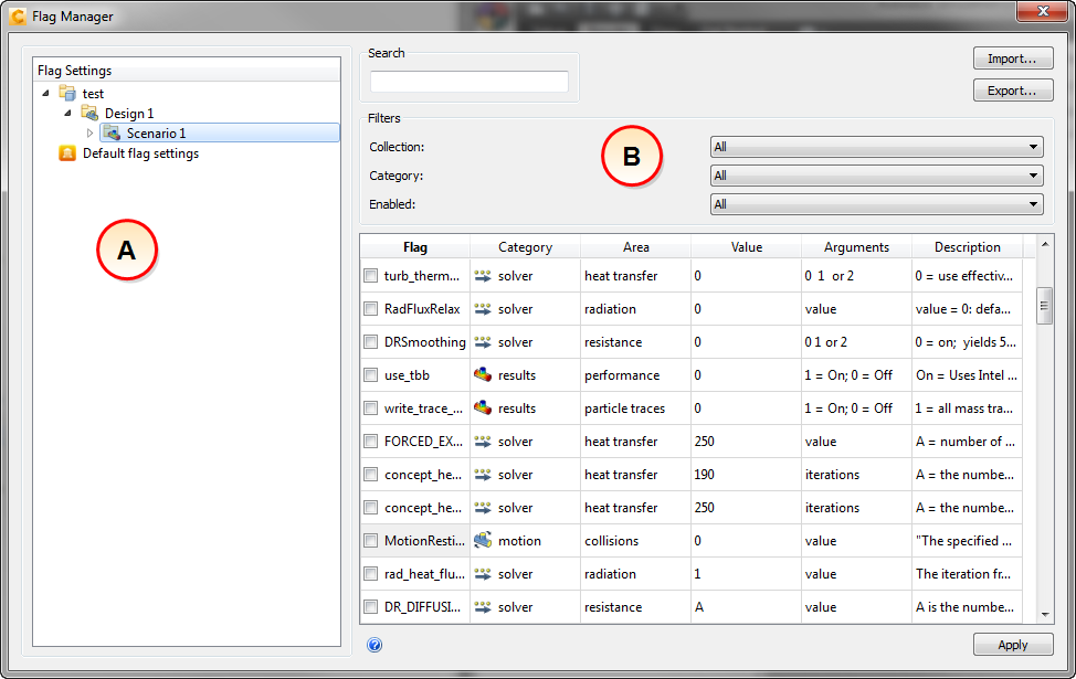

The Flag Manager dialog contains two primary panes:
- The Flag Settings pane is on the left. This shows which flags are selected as Default flags and which are active in the scenario.
- The Flag List pane is on the right. This is the complete list of flags.
