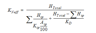

The Effective Normal Conductivity is calculated using the equation:
