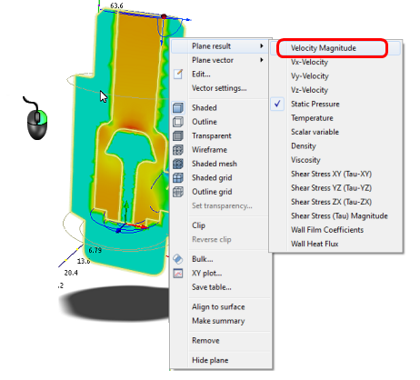

1. Let's first change the result back to Velocity Magnitude. Right click on the plane and selecting Plane result > Velocity Magnitude:

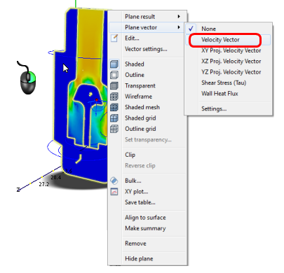

2. To show vectors, right click on the plane, click Plane vector, and Velocity Vector:

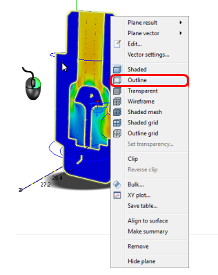

3. To see the vectors better, right click on the plane, and click Outline:
You should see this:

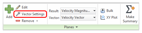

4. From the Planes context panel, click Vector Settings:

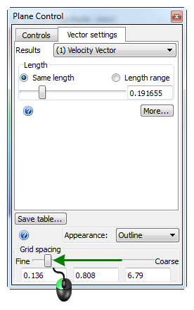

5. On the Plane Control dialog, drag the Grid spacing slider toward Fine:

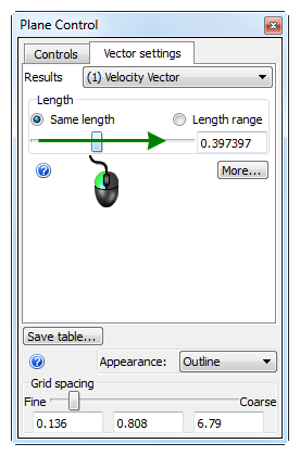

6. On the Plane Control dialog, drag the Length slider to the right:

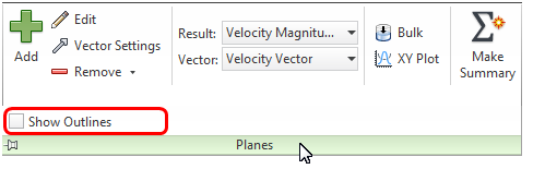

7. Click the drop down menu on the Planes context panel, and uncheck Show Outlines:
The view should look like this:
The vectors show that the flow in our valve is very active. It accelerates around the poppet, circulates downstream of it, and separates off of the discharge pipe on the inside corner.
