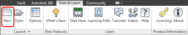

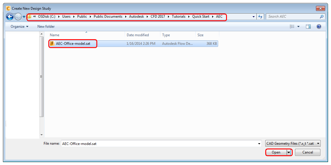

1. Start Autodesk® CFD, and click New.

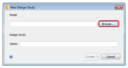

2. On the New Design Study dialog, click Browse...
3. Navigate to C:\Users\Public\Public Documents\Autodesk\CFD 2017\Tutorials\Quick Start\AEC, and select AEC-Office-model.sat. Click Open.

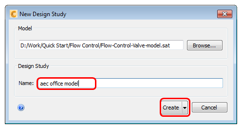

4. On the New Design Study dialog, enter a name for the Name, make sure the button option is set to Create, and click Create:

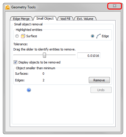

5. You will probably see a dialog called "Geometry Tools." Close it by clicking the "X" in the top right corner:
This dialog indicates that small edges were found, but we will not remove them because they are an intentional part of the model.

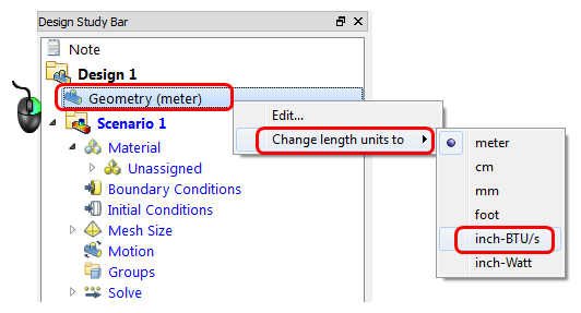

6. The geometry imports in units of meters, but we need to convert it to inches. To do this:
What it should look like:

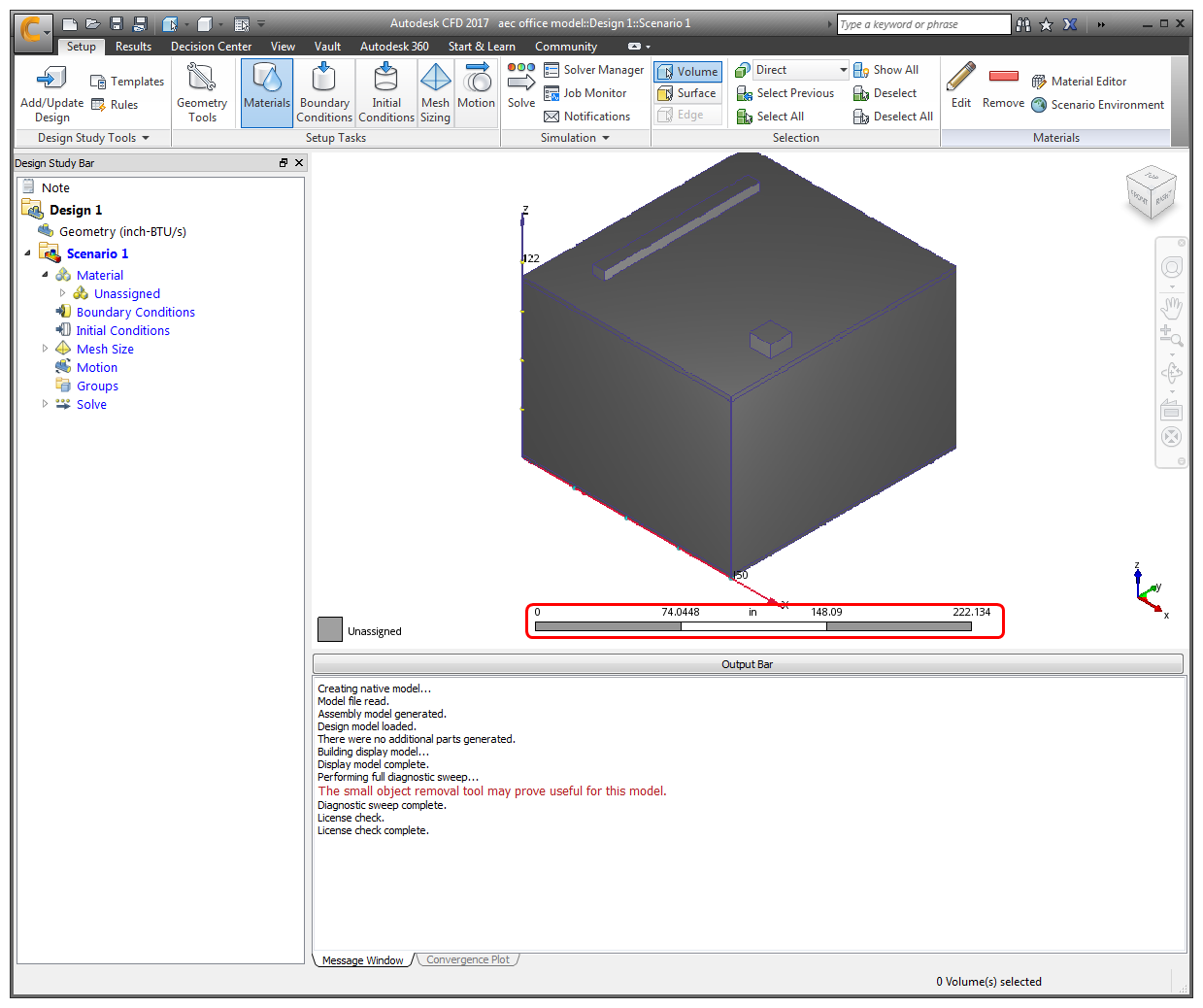

Autodesk® CFD starts, and you should see the model. Note the dimension values on the axes:
Note: In the next step we rotate the model so you can see more of the structure.
