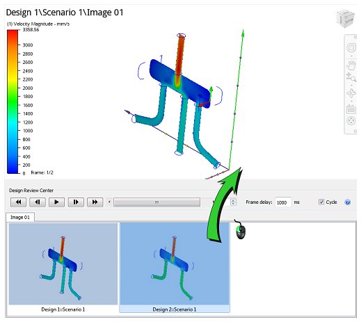

- A thumbnail image from each scenario appears in the Design Review Center. If a scenario has not been run or needs to be updated, a place-holder image appears instead.
- The first image is shown in the Graphics window. To show the others, left click on each and drag into the graphics window.
To compare the views, use the Design Review Center slider and animation controls.

-  Click View (tab) > Windows (panel) > Viewports. Select one of the Multi-View options from the menu (Vertical Split, Horizontal Split, etc.)
-  Change the image in a view port by dragging an image from the Design Review Center tab into one of the view ports.
The viewport with the Autodesk® CFD icon in the lower right corner is the active view, and can be navigated. To activate a different viewport, simply click on it. To navigate multiple views together, click View (tab) > Windows (panel) > Link Views.
