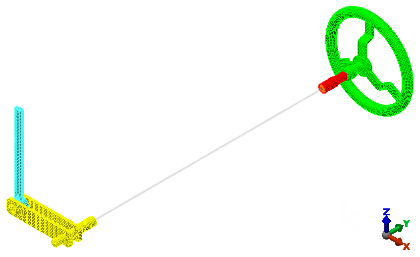

  5. Click the Home icon immediately above the ViewCube for an isometric view of the model.
    Note: The Home icon will not be visible until the cursor is at or near the ViewCube.
    The model should look like the following image:
