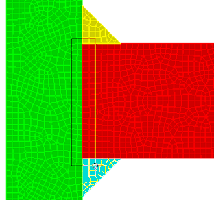

Now we define surface contact between the horizontal part and the vertical part.
Selection
Shape
Point or Rectangle and
Select
Surfaces commands active...
Surface Contact. These two surfaces will not be able to penetrate each other but will freely slide or separate. The
Surface Contact
option ensures that tensile and shear loads are only carried by the welds.
