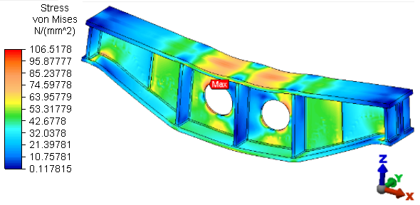

We now look at the von Mises stress results and compare the maximum value with the allowable stress.
Results Contours
Stress
von Mises. The maximum stress is between 106 and 107 N/mm2, which exceeds the target maximum design stress of 90 N/mm2.
Results Inquire
Probes
Maximum. The maximum stress occurs along the edge of one of the web holes.
