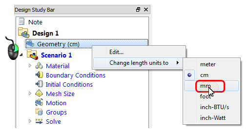

1. Ensure units are set to mm on the Geometry branch of the Design Study Bar.
Autodesk® Inventor, PTC Creo, and Solidworks:
Units should already be mm. No action required.

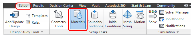

2. Click Materials on the Setup tab:

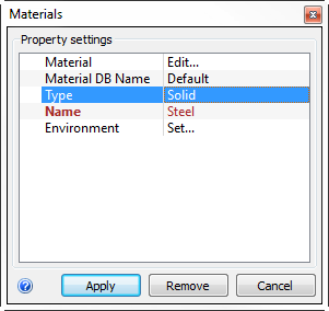

3. Left click on the Car Body. Click the Edit button in the context toolbar.
Type = Solid, Name = Steel, click Apply.
Note: Fields in the right column become menus when you click on them.

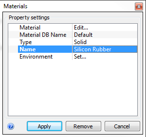

9. Select the four wheels and click the Edit button from the context toolbar.
10. Type = Solid, Name = Silicon Rubber, click Apply.

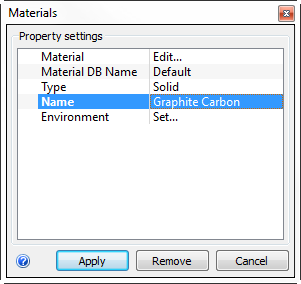

12. Select the rear seat, the two front seats, and the console. Click the Edit button from the context toolbar.

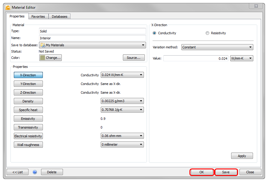

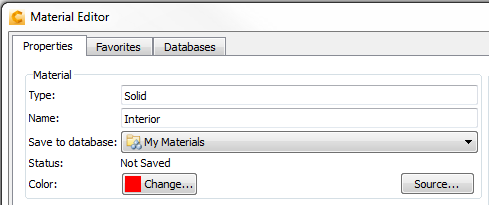

13. Type = Solid, Name = Graphite Carbon. Click Edit on the Material line.

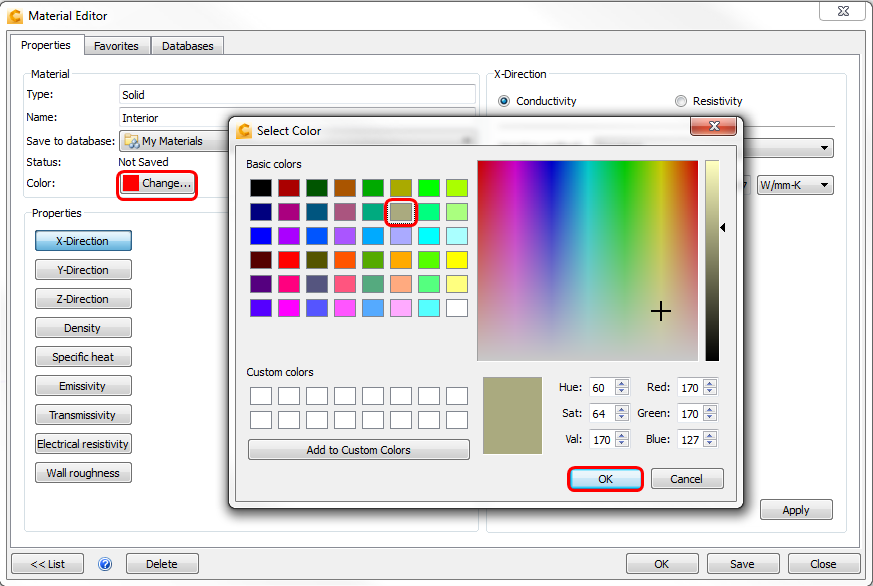

14. On the Material Editor, Name = Interior, Save to database = My Materials.
15. Click Color: Change. In the Select Color dialog, select a tan color, and click OK.
Note: We could also have modified physical properties in the Material Editor, if appropriate.
16. To save the new material to your custom material database, click Save and OK in the Material Editor.
17. To apply the "Interior" material, click Apply on the Material quick edit dialog.

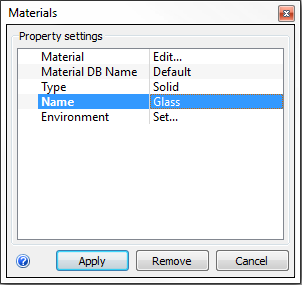

23. Left click off the model, and click the Edit icon in the context toolbar.
24. Type = Solid, Name = Glass, click Apply.

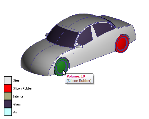

26. Confirm that all parts are assigned the proper material:
