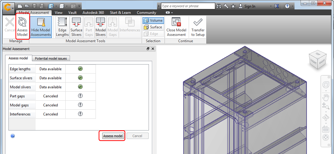

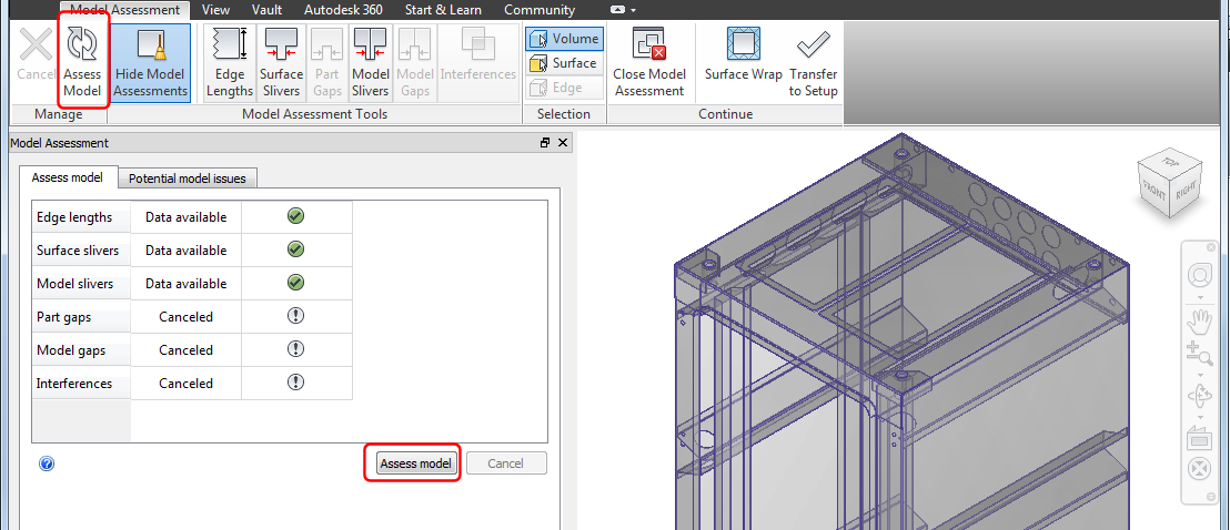

Tools for assessing the Model
Because many geometric issues are very small, they can be difficult to locate, especially within a complex model. The Model Assessment Toolkit interrogates the geometry to identify a series of known geometric issues that frequently occur in CAD models.
For each part, the Toolkit looks for these issues:
For each assembly, the Model Assessment Toolkit looks for these issues:
The Toolkit identifies issues, but does not provide tools for fixing them. It's usually best to resolve issues in the CAD system or in Autodesk® Sim Studio. In some cases, issues are not important and can simply be ignored. In other cases, they should be addressed to reduce the chances of meshing errors and potentially much longer simulation times. It often required engineering judgement to determine what should be fixed.
You can start the Model Assessment Tool when launching from a CAD system by selecting the Active Model Assessment Tool option in the Autodesk CFD launch commands. When opening a geometry file, check the box called Import into Model Diagnostics on the New Design Study dialog.
To learn more about the Model Assessment Toolkit, click here.
