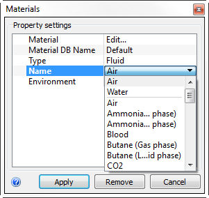

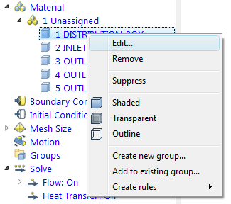

The default Material setting for every part in a new Scenario is "Unassigned". This is not a valid material setting for an analysis, so all parts must be assigned a material prior to running.
The purpose of this is to make it obvious if a material assignment is lost after updating the geometry of a Design. Additionally, assigning materials with Rules on Parts is simplified because it is clear which parts have materials, and which do not.
Before a Scenario can be run, a material must be assigned to all parts. An error is given if one or more parts are unassigned when the analysis is started.

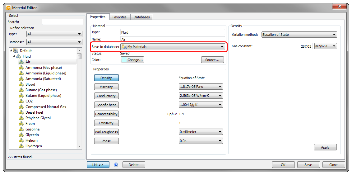

The Default material database contains at least one instance of every material type. A convenient way to create a new material is to use a Default material as an example. Because these materials are read-only, use the Material Editor to copy the original into a custom database, and modify the copy.
The Default material database contains a single version of each material. Most are defined with variable properties.

To open the Material Editor, click Material Editor from the Materials context panel.
Click the Databases tab.
It is often necessary to select the database when assigning and creating materials. There are several ways to do this from the Material Editor:
When applying a material, select the database directly from the Material quick edit dialog on the Material DB Name line.
