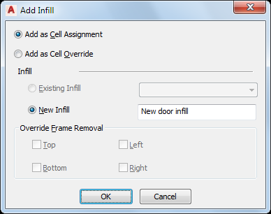

Use this procedure to add doors, windows and door/window assemblies to a curtain wall.
The Add Infill worksheet opens.
| If you want to… | Then… |
| add the door, window or door/window assembly as a cell assignment and have all curtain walls using the same style display the same object added in a corresponding cell | select Add as Cell Assignment. |
| add the door, window or door/window assembly exclusively to the selected curtain wall | select Add as Cell Override. |
If a door, window or door/window assembly of the style you selected already exists in your drawing, Existing Infill is selected by default.
| If you selected… | Then… |
| Add as Cell Assignment and you want to insert a door, window or door/window assembly of the existing style, Existing Infill is selected by default. | Click OK. |
| Add as Cell Assignment and you want to insert a door, window or door/window assembly of a different style than exists in your drawing | select New Infill, enter a name for the object and click OK. |
| Add as Cell Override and you want to insert a door, window or door/window assembly of the existing style and not modify the edge of the frame surrounding the object | Click OK. |
| Add as Cell Override and you want to insert a door, window or door/window assembly of a different style than exists in your drawing and not remove an edge of the frame surrounding the object | select New Infill, enter a name for the object and click OK. |
| Add as Cell Override and you want to insert a door, window or door/window assembly of the existing style and remove an edge of the frame surrounding the object | select Top, Bottom, Left, or Right for Override Frame Removal and click OK. |
| Add as Cell Override and you want to insert a door, window or door/window assembly of a different style than exists in your drawing and remove an edge of the frame surrounding the object | select New Infill and enter a name for the object. Then select Top, Bottom, Left, or Right for Override Frame Removal and click OK. |
