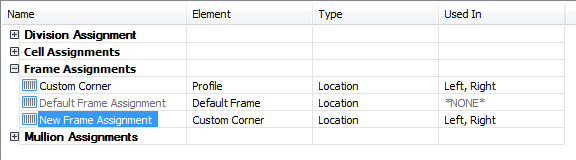

- Click New Frame Assignment.
A new frame assignment is displayed in the list of frame assignments.
New frame assignment
- Select the frame assignment in the right pane, right-click and click Rename, and then enter a descriptive name.
- Select a frame definition from the Element column.
- Specify the sides of the frame to use this frame assignment.
- Click OK.
