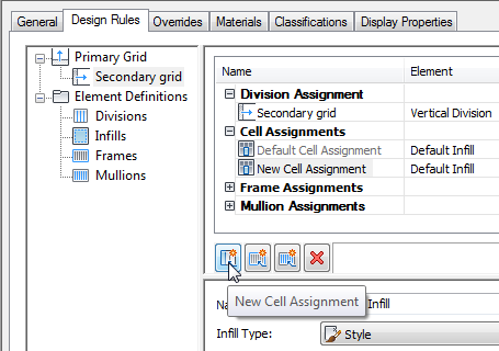

- Click the Design Rules tab.
- In the left pane, select the grid in which you want to put a simple panel infill.
- Click New Cell Assignment.
A new cell assignment is displayed in the list of cell assignments.
