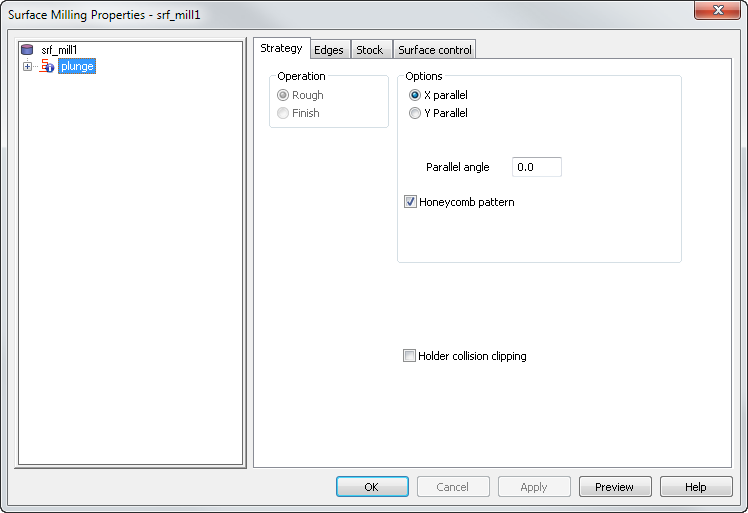

X parallel — Select this option to arrange the drilling operations parallel to the X axis.
Y parallel — Select this option to arrange the drilling operations parallel to the Y axis.
Parallel angle — Optionally enter an angle in degrees. You can have the toolpath at any angle. The angle is measured counter-clockwise from the X axis if X parallel is selected or counter-clockwise from the Y axis if Y parallel is selected.
Holder collision clipping — Clips the toolpath where the holder or shank collides with a part surface, check surface, or unmachined stock. When selected, the Holder clearance and Shank clearance attributes are displayed on the Milling tab for the operation.
