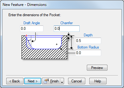

  4. Click Next to open the New Feature - Dimensions page.
  5. If a dimension field has a blue label, you can click it and 'pick' the dimension from objects in the graphics window.
    • Depth — Enter the distance cut into the material in Z.
    • Draft angle — Optionally set an angle for the feature wall. Use only positive numbers.
    • Chamfer — Optionally enter the depth of a 45 chamfer cut at the top edge of the feature. Leave this value at the default, 0, for no chamfer.
    • Bottom Radius — Optionally set a bottom radius for the feature. The radius corresponds to the shape of the cutter. By default, the material is milled using a flat-bottomed mill, making stair-step passes when close to the radius. Then a rough and finishing pass is made with the radiused mill. The default value is 0, which cuts a square corner.
