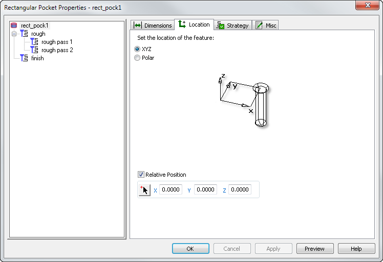

Location tab (Milling)
Use the Location tab of the Feature Properties dialog to specify the location of a feature.
Relative Position — This sets the XYZ coordinates relative to the UCS (or Setup origin). If deselected, the coordinates are relative to the World Coordinate System.
