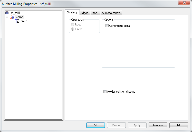

Strategy tab (Isoline finish)
Continuous spiral — Enable this option to stop the tool lifting from the surface when machining.
Holder collision clipping — Clips the toolpath where the holder or shank collides with a part surface, check surface, or unmachined stock. When selected, the Holder clearance and Shank clearance attributes are displayed on the Milling tab for the operation.
