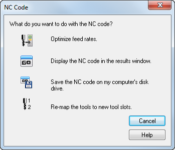

After you have generated toolpaths, the NC Code step is available to you. Click the NC Code icon in the Steps toolbox to open the NC Code dialog:
The options are:
Optimize feed rates — Click the icon to open the Feed Optimization dialog.
Display the NC code — Click the icon to view the NC code on the NC code tab of the Results window.
Save the NC code — Click the icon to open the Save NC dialog.
Re-map the tools — Click the icon to open theTool Mapping dialog.
