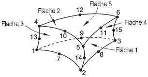

13-Knoten-Pyramide n. z.
SOLID95 (Pyramidenoption)
SOLID186 (Pyramidenoption)
SOLID226 (Pyramidenoption)
CPYRA
