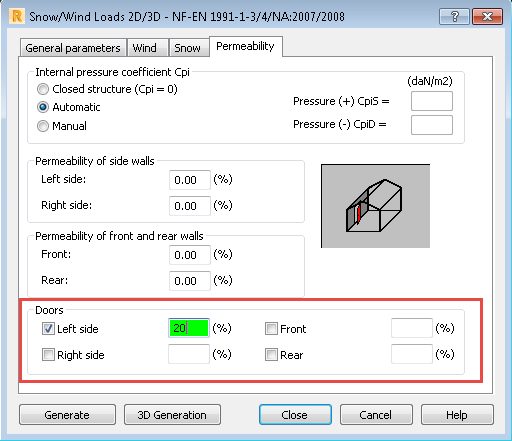

In generation of wind loads, the presence of dominant wall, as specified in point 7.2.9.(5), is now considered.
According to point 7.2.9.(5), for a building containing faces with openings whose area is at least twice the area of openings in the remaining faces of this building, the internal wind pressure should be taken as a fraction of the external pressure acting on this face.
This improvement applies to options for defining doors on the Permeability tab of the Snow/Wind Loads 2D/3D dialog.
