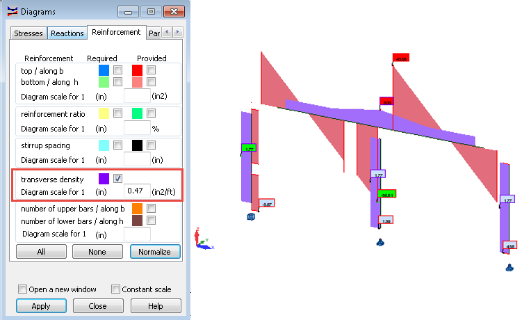

Density of Transversal Bar Reinforcement
This new feature allows you to display diagrams of density of required transversal reinforcement of bars and export it to Revit.
Access the transverse density feature from the RC Members - required reinf. layout by selecting Results Diagrams for Bars. See Reinforcement Diagrams.
