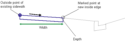

Behavior
By default outside edge of footpath is located at the attached marked point or at the associated alignment. Similarly, the level is set based on marker point associated, or profile, or from the surface at that offset.
Once this start point is established,footpath structure links are inserted inwards from this point for given width, slope, and depth. If a name is given for Mark Inside Point, a marked point is stored at the new low edge of the footpath.
Layout Mode Operation
In layout mode, this subassembly starts at the attached point and draws a single shape with given dimensions, such as width, slope and depth.
Note:
While constructing an assembly, it is recommended that this subassembly be added at a controlling offset, if there is no previously marked point. This controlling offset could be at a decent offset from the baseline marker, so that the layout mode looks like a typical section. However, it is recommended that the user doesn't have to map this controlling offset to any "alignment/profile" in the corridor state, as that would cause problems such as making the design not perpendicular to the baseline in some cases. Not associating this controlling offset will not have any effect on the corridor, as the start point is attached to an alignment/marked point through the subassembly macro for an exact location.

Coding Diagram
