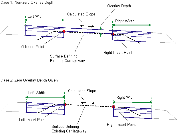

This subassembly overlays an existing uncrowned road, and adds one or more travel lanes to the left and right edges while matching the existing lane slope.
The attachment point is at the inside edges of the finish surface on the widening lanes.

The levels of the Left and Right Insert Points on the Existing Surface are determined, and the slope is calculated between the two points. If a non-zero Overlay Depth is given, an overlay layer is added above the existing lane at the calculated slope. A closed overlay shape is created by superimposing one or more links over the existing gradient. The widening lanes are inserted outward from the overlay edges for the given widths at calculated slope.
If the Overlay Depth is given as zero, the widening lanes are inserted outward from the insert offsets at the existing gradient.
The pavement layers are closed with vertical links at each end. A single vertical link is also placed from the inside edge of Subbase to the existing surface.

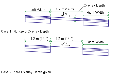

In layout mode, this subassembly is attached to any convenient point. The overlay layer is shown at a uniform depth for a width of 4.2 meters or 14 feet at a slope of -2%. The widening lanes extend from the edges-of-overlay at the given widths and depths at the -2% slope.
In modeling mode the subassembly adjusts to the positions and slopes determined by the Insert Points and the Existing Surface.

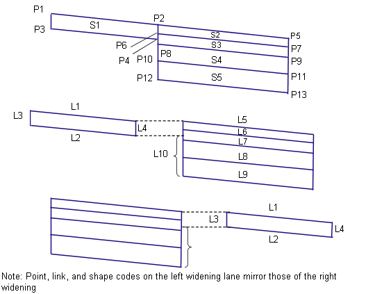

The following table lists the point, link, and shape codes for this subassembly that have codes assigned to them. Point, link, or shape codes for this subassembly that do not have codes assigned are not included in this table.
Point, Link, or Shape |
Code |
Description |
P5 |
EC |
Outside edge of widening lane on finish surface |
P7 |
EC_Pave1 |
Outside edge of widening lane on Pave1 |
P9 |
EC_Pave2 |
Outside edge of widening lane on Pave2 |
P11 |
EC_Base |
Outside edge of widening lane on Base |
P13 |
EC_Sub |
Outside edge of widening lane on Subbase |
L1, L5 |
Top, Pave |
Finish surface |
L2 |
Overlay |
Superimposed over links on the Existing Surface. Note that there may be more than a single link between points P3 and P4. |
L6 |
Pave1 |
L7 |
Pave2 |
L8 |
Base |
L9 |
SubBase, Datum |
L10 |
Datum |
S1 |
Overlay |
Area between the overlay and existing lane |
S2 |
Pave1 |
S3 |
Pave2 |
S4 |
Base |
S5 |
SubBase |
