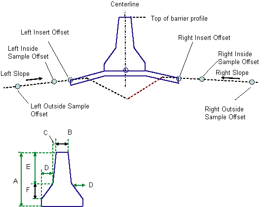

This subassembly widens an existing divided highway by extending from the travel lane edges inward over a depressed central reserve, with a symmetrical barrier at the centerline. The central reserve slopes may vary somewhat from the existing slopes to make both sides meet at the centerline, or to hold the top of the barrier to a profile.
The attachment point is at the midpoint of the base of the barrier.

Left Insert Offset |
Offset where the central reserve extension layer begins on the left side. |
Numeric |
0.0 |
Left Inside Sample Offset |
Offset of the inside sample point on the left side. The slope of the left side is calculated on the existing surface between the sample points. |
Numeric |
0.0 |
Left Outside Sample Offset |
Offset of the outside sample point on the left side. The slope of the left side is calculated on the existing surface between the sample points. |
Numeric |
0.0 |
Right Insert Offset |
Offset where the central reserve extension layer begins on the right side. |
Numeric |
0.0 |
Right Inside Sample Offset |
Offset of the inside sample point on the right side. The slope of the right side is calculated on the existing surface between the sample points. |
Numeric |
0.0 |
Right Outside Sample Offset |
Offset of the outside sample point on the right side. The slope of the right side is calculated on the existing surface between the sample points. |
Numeric |
0.0 |
Dimension A (mm or inches) |
Height of the barrier from the base on the high side of the central reserve to the top of the barrier. |
Numeric, positive |
810 mm 32 in |
Dimension B (mm or inches) |
As shown in diagram. |
Numeric, positive |
232 9 in |
Dimension C (mm or inches) |
Numeric, positive |
59 mm 2 in |
Dimension D (mm or inches) |
Numeric, positive |
125 mm 5 in |
Dimension E (mm or inches) |
Numeric, positive |
557 mm 22 in |
Dimension F (mm or inches) |
Numeric, positive |
178 mm 7 in |
May be used to calculate the offset of the left insert point from an alignment. The following object types can be used as targets for specifying this offset: alignments, polylines, feature lines, or survey figures. |
Optional |
May be used to calculate the offset of the left inside sample point from an alignment. The following object types can be used as targets for specifying this offset: alignments, polylines, feature lines, or survey figures. |
Optional |
May be used to calculate the offset of the left outside sample point from an alignment. The following object types can be used as targets for specifying this offset: alignments, polylines, feature lines, or survey figures. |
Optional |
May be used to calculate the offset of the right insert point from an alignment. The following object types can be used as targets for specifying this offset: alignments, polylines, feature lines, or survey figures. |
Optional |
May be used to calculate the offset of the right inside sample point from an alignment. The following object types can be used as targets for specifying this offset: alignments, polylines, feature lines, or survey figures. |
Optional |
May be used to calculate the offset of the right outside sample point from an alignment. The following object types can be used as targets for specifying this offset: alignments, polylines, feature lines, or survey figures. |
Optional |
The left and right slopes are calculated between the sample points on each side.

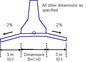

In layout mode, a central reserve and barrier are drawn with the fixed dimensions as shown in the following diagram. This is the same figure that is drawn in layout mode for the OverlayCentralReserveAsymmetrical subassembly.
