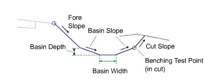

This subassembly builds the links for the basin foreslope and the basin out to the basin test point. If a profile is given, the width of the foreslope varies to hold to the basin profile. If the basin test point is in cut, the daylight intercept is calculated on the target surface at the given cut slope.
If it is in fill, and Benching is set to Include, a top-of-benching link is added, and the daylight intercept is calculated on the target surface at the given Fill Slope. The daylight link is not inserted if Omit Daylight Link is set to True. If the top-of-benching link intersects the target surface, the section is terminated at the intersection.

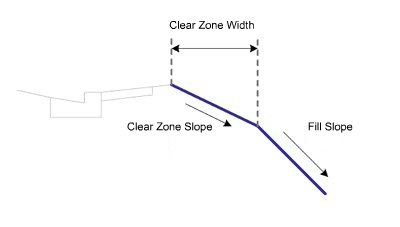

If it is in fill, and Benching is set to Omit, a link is added from the attachment point at the Clear Zone Slope until the Clear Zone Width is met. Then a daylight link is added to the target surface at the fill slope specified. If the clear zone link intersects existing ground, it will stop at this intersection point.
