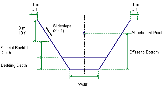

This subassembly creates a flat-bottom trench with equal sideslopes and up to three layers of backfill material.
The attachment point is at the Offset To Bottom distance above the midpoint of the base of the trench.

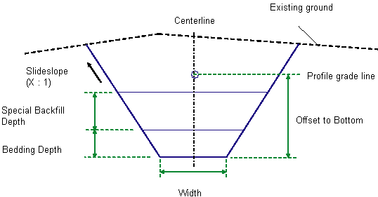

The elevation of the bottom of the trench is calculated as the profile grade line elevation minus the Offset To Bottom value. The horizontal trench bottom link is placed symmetrically about the attachment point offset at that elevation, and the sideslopes are extended upward to the Existing Surface. The horizontal Bedding link is placed at the given depth above the trench bottom. The horizontal Special Backfill link is placed at the given depth above the Bedding link.

In layout mode, the trench and existing surface are drawn as shown below.
