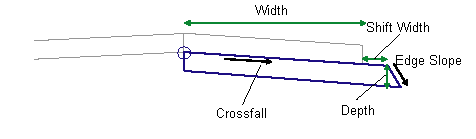

This subassembly creates a simple pavement structure with user-definable point, link, and shape codes.
This subassembly can be used as a lane or shoulder using superelevation parameters for the slope. The width and outside edge level can be calculated based on an optional alignment and profile. This subassembly can be stacked one below another to form multiple layers, or butted side by side to form multiple lanes with or without gradient breaks. If multiple GenericPavementStructure subassemblies are stacked, the bottom slope can be used as the top slope of subsequent layers. Optionally, the bottom width of the subsequent subassembly can be assigned as the width of the previous subassembly.
The attachment point is at the upper inside edge of the pavement structure.
Note: All dimensions are in meters or feet unless otherwise noted. All slopes are in run-over-rise form (for example, 4 : 1), unless indicated as a percent slope with a “%” sign.

This subassembly builds a skeletal subassembly that lets you specify various parameters. All point, link, and shape codes can be user-defined as needed. Additionally, this subassembly can get slopes from a target parameter (profile), or from the superelevation specified on the alignment. It can also assign the width from an offset alignment.
While defining an assembly, you can assign the width of the previous subassembly (the one above), plus a shift width to the subassembly, so that stepped layers are possible.
In layout mode, the subassembly draws the lane using the input parameter values.
