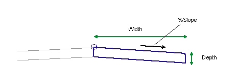

This subassembly creates a simple lane.
The attachment point is at the inside edge of lane on finish grade.

Width |
Width of the lane |
Numeric, positive |
3.6 m 12.0 ft |
Depth |
Depth from finish grade to subbase |
Numeric, positive |
0.2 m 0.67 ft |
%Slope |
% Slope of the lane |
Numeric |
-2% |

The subassembly builds a finish grade and subbase surface, closed by vertical links at either end. The lane is inserted outward from the attachment point for the given width, depth, and slope.
In layout mode, this subassembly draws the lane using the input parameters.
