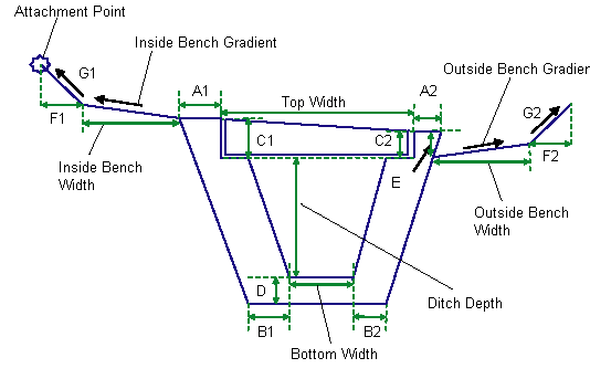

This subassembly creates a ditch structure to add to either the left or the right sides of the assembly.
Optionally, this subassembly can add daylight links on either side of the structure.
The attachment point is at the innermost point on the grading links preceding the ditch structure. If the grading links on the inside are omitted, then the attachment point is on the innermost point of the inside wall.

| Parameter | Description | Type | Default |
| Side |
Specifies to insert the subassembly either on the right or the left side of the attachment point. |
Left / Right | Right |
| Ditch Depth | Depth of the ditch on the inside | Numeric, Positive |
2.0ft 0.6m |
| Bottom Width | Bottom width of the ditch | Numeric, Positive |
1.0ft 0.3m |
| Top Width | Ditch opening at the lid | Numeric, Positive |
2.0ft 0.6m |
| Lid Gap | Gap between the lid sides and the inside walls | Numeric, Positive |
0ft 0m |
| A1 | Top inside wall thickness near the lid | Numeric, Positive |
0.45ft 0.15m |
| B1 | Inside wall thickness of the ditch structure | Numeric, Positive |
0.6ft 0.2m |
| C1 | Lid depth on the inside | Numeric, Positive |
0.6 ft 0.2 m |
| D | Ditch bottom bed depth | Numeric, Positive |
0.6 ft 0.2 m |
| Inside Bench Width | Width of the (optional) inside bench. Enter ZERO for no bench | Numeric, positive |
1.5 ft 0.5 m |
| Inside Bench Gradient | Cross gradient of the (optional) inside bench. It is measured away from the ditch structure edge, and a positive slope indicates rising bench from the ditch | Numeric, Gradient type | 4% |
| F1 | Inside backslope link (optional) width. Enter ZERO value for no backslope link | Numeric |
1.0 ft 0.3 m |
| G1 | Slope of the (optional) inside backslope link. It is measured away from the ditch structure, and a positive slope indicates rising link from the start point | Numeric, Slope type | 1:1 |
| A2 | Top outside wall thickness near the lid | Numeric, Positive |
0.45 ft 0.15 m |
| B2 | Outside wall thickness of the ditch structure | Numeric, Positive |
0.6 ft 0.2 m |
| C2 | Lid depth on the outside | Numeric, Positive |
0.45 ft 0.15 m |
| E | Depth of the hinge point where the start of outside bench/backslope links is located | Numeric, Positive |
0 ft 0 m |
| Outside Bench Width | Width of the (optional) outside bench. Enter ZERO for no bench | Outside Bench Width |
3.5ft 1.1m |
| Outside Bench Gradient | Cross gradient of the (optional) outside bench. It is measured away from the ditch structure edge, and a positive slope indicates rising bench from the ditch | Outside Bench Gradient | 4% |
| F2 | Outside backslope link (optional) width. Enter ZERO value for no backslope link | Numeric, Positive | 0.3 |
| G2 | Slope of the (optional) outside backslope link. It is measured away from the ditch structure, and a positive slope indicates rising link from the start point | Numeric, Slope type | 1 : 1 |

The subassembly builds the shape for a ditch structure, as shown in the above illustration. To omit the daylight and bench links, enter a zero value for the appropriate width parameters.
In layout mode, this subassembly draws as it is defined using the input parameters, starting from the attachment point.
