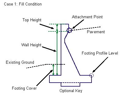

This subassembly inserts a retaining wall structure with one side tapered, and is typically used if walls are 5.5 meters or higher.
This subassembly also adds an optional key at the bottom.

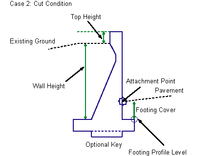

The attachment point varies depending on whether the retaining wall is in a cut or fill condition. If it is in a fill condition, the attachment point is near the top of the retaining wall. In a cut condition, the attachment point is near the footing.
Note: All dimensions are in meters or feet unless otherwise noted. All slopes are in run-over-rise form (for example, 4 : 1), unless indicated as a percent slope with a “%” sign.

Wall height is determined from the top of the footing to the attachment point of ground level on the vertical face, whichever is higher. Width and depth of the footing are measured as a function of the wall height. Wall vertical face is located at ¼ of the footing width, and the bottom of battered slope is at 300 mm from the other edge. Optional key is locate right at the center of the footing at 300mm deep and 600mm wide.

This subassembly can be inserted on either the left or the right sides. The attachment point is different for the fill or cut condition. In fill, the attachment point is assumed to be where the finish surface intersects the inside face of the wall, at a distance below the top of the wall equal to the Top Height parameter. In a cut condition, the attachment point is assumed to be where the finish surface intersects the inside face, above the top-of-footing at a distance equal to the Footing Cover parameter. The wall height is determined from the Wall Height or Profile input.
In a fill condition, the sloping wall face is toward the center of the carriageway. In a cut condition, the sloping wall face is away from the carriageway, toward the earth being retained. If the Key option is set to No, then the base of the footing is a single horizontal link. If the Key option is used, links to define the optional key are created.
In layout mode, the subassembly draws the retaining wall shape as specified by the input parameter values, assuming that the subassembly is in a fill condition.

Fill Condition
Cut Condition
