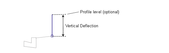

This subassembly is a general purpose utility to add a vertical surface link by vertical deflection.
A profile can be used when building a corridor model to allow variable vertical deflection.

Behavior
A vertical link is added from the attachment point for the given vertical deflection. If a profile name is given for the Vertical Deflection, the end of the link will match the profile level.
Layout Mode Operation
In layout mode, this subassembly displays the link for the given +/- vertical deflection.
