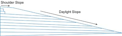

This subassembly inserts a shoulder that you can use to control superelevation. It also supports Pave 2 and Pave 3 Layer extension, as well as varying gradient on Datum.
The attachment point is at the inside edge of the paved shoulder, which is typically at the outside edge of carriageway.
Note: All dimensions are in meters or feet unless otherwise noted. All slopes are in run-over-rise form (for example, 4 : 1) unless indicated as a percent slope with a “%” sign.

This subassembly is inserted on the side of the attachment point specified. All links follow the slope specified for the top link L1, with the exception of L10. Link L10 is determined by the Subbase 3 Inner Depth and Super Elevation/Gradient on Link L1, if a User specified Gradient is not given for L10.
In layout mode, this subassembly displays the links comprising the shoulder for a normal crowned carriageway situation. If numeric slope values are given for the Shoulder % Slope and Subbase % Slope, the links are shown at the given slope values. Otherwise the default slopes of -2.50% are used.
