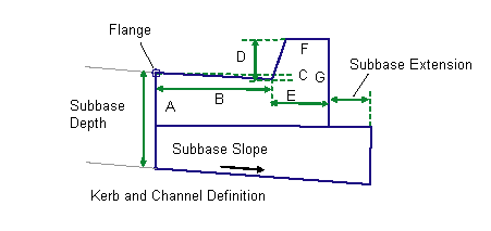

Dimension A
(mm/in)
Depth of the channel at the flange point.
Numeric, positive,
non-zero
175 mm
7 in
Dimension B
(mm/in)
Width from the flange point to the channel invert level.
400 mm
16 in
Dimension C
(mm/in)
Depth from the flange point to the channel invert level.
Numeric, positive,
non-zero
25 mm
1 in
Dimension D
(mm/in)
Height of kerb from the channel invert level to the top-of-kerb.
Numeric, positive,
non-zero
150 mm
6 in
Dimension E
(mm/in)
Width from the channel invert level to the back-of-kerb.
Numeric, positive,
non-zero
200 mm
8 in
Dimension F
(mm/in)
Width of the top-of-kerb.
Numeric, positive,
non-zero
150 mm
6 in
Dimension G
(mm/in)
Height of the back-of-kerb.
Numeric, positive,
non-zero
325 mm
13 in

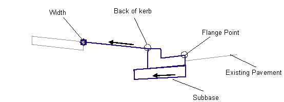

This subassembly is used to place a new kerb and channel parametrically, and can optionally tie (with a sod strip) into either the inside edge of the existing footpath, or to a new footpath created with another subassembly. The horizontal placement of the kerb and channel is determined from the previously know flange point location. Highside of the sod strip can be located either by a fixed offset or any other marked point, such as inside edge of footpath. Alternatively this point can come from the target parameter of an aligment and profile. Newly designed flange point, optionally marked so that it can be used as input later for replacement lane subassemblies.
Key steps in completing this conditional subassembly are as follows:
  1. From flange point offset and the input parameters locate the offset of “back of kerb”.
  2. From the target parameter, get the "back of kerb" level at that chainage and establish this point P4.
  3. From this point establish all kerb and channel points and links using the input parameters (similar to UrbanKerbChannelGeneral1
  4. If inside footpath marked point is assigned, establish that point as P10. If marked point is not associated, look for target parameters for "inside edge of footpath" alignment. If yes then get profile level or from the surface target parameter.
  5. If none of the above data is available for the highside of the sod strip, use the offset as dictated by attachment point to establish point P10.
All other kerb and channel links are inserted based on the Input Parameter dimensions Dimension A - Dimension F. All dimensions must be positive, non-zero values. If a non-zero subbase depth is given, the subbase layer is inserted to the back of kerb, and continues for the Subbase Extension width. The subbase layer closes to the bottom-back-of-kerb as shown in the diagram.
Layout Mode Operation
In layout mode the subassembly is set based on the attachment point and the default flange point offset from baseline. Width of the sod strip is computed by subtracting the kerb and channel total width from "flange point to attachment point" distance. Use 2% slope to calculate the low side of sod strip (or back of kerb point), from which the rest of kerb and channel is drawn using the input parameters given.
